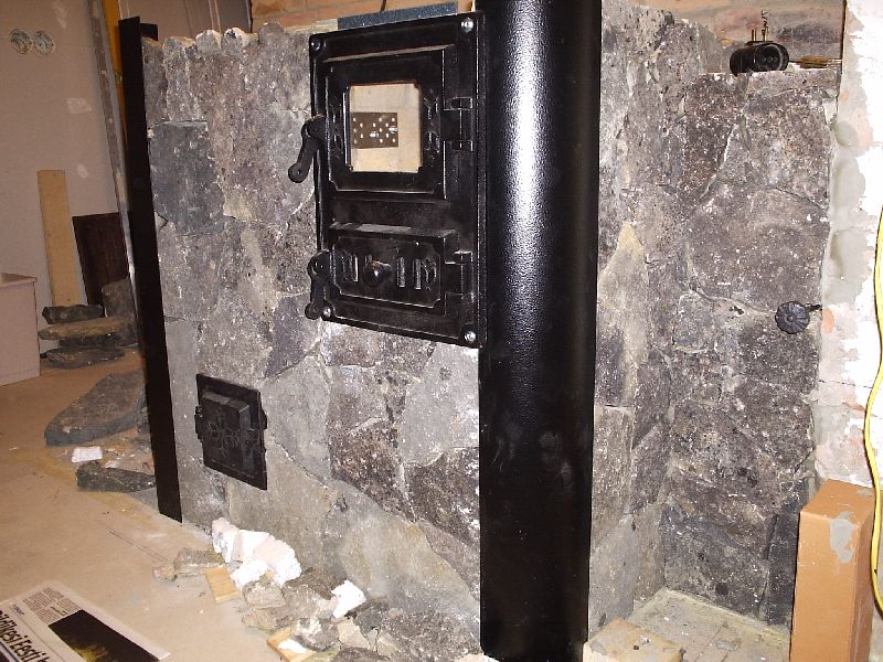

Vanal aastal sai Sulu küla uue suitsu. Seda siis küla majja, kus seltsis segasem tänagi pidu panna!

Originaali autorilt ka tagasiside aga ärge te võõramaalasi küll minu tegude pärast sõimama hakake :beg:
Hi Raivo and Kerri
Happy new year to you to.
Have we talked before ? I dont remember your names ???
Thank you for the pictures.
It seems like you got it allmost right.
You just made the holes a little to big i think.
As you can se on the picture where you have a fire going on, some of the
flames leave the room before they are completely burned. This schould not
happen.
On the film: "Pictures from work-shop":
http://www.youtube.com/ildsjalen#p/u/4/5O1L5jKRz_E you can se theese holes
as we make them. (It goes fast since you se 6.200 pictures in 10 mintes, but
you can just stop the film when you get to the pictures you want to watch
closer).
I think you maybe could adjust the size of the holes by adding smal pices of
bricks in the corners.
But exept from that, its nice to se, that people all over the world is
taking up some of my ideas and try them out :-))
Thank you for sharing this with me.
Your wellcome to write to me in your own languish if you preferre, if you
just are carefull to awoid mispellings.
Then i can use googletranslate to se it in english. (This is better for me
since translation from one "little" languish to another "litle languish is
difficult for google.
All the best for you
Lars

Kas sellel ahjul on uksel kinnituspoldid väljaspoolt pandud?Ja kui on,siis mis põhjusel?Kas uks on miskit sarnast, kui siin, http://www.e-kamin.ee/index.php?page=20 ... 7&selected

See on just see kaminauks ja sellel puuduvad ahjuuksele omased kinnitused ja seepärast tuleb igal oma kinnitus leida. Seda, et need poldid kohe kivi sisse lähevad ei maksa ka arvata.

Ja kuidas nad siis lähevad,kui otse ei lähe :roll:.Ega siin palju variante pole vist,üks on näiteks tüüblisse?Või?Kas vill on ka ikka vahel,nagu tavapäraselt?Muidu on ilus ahi :good:

voltts kirjutas:Ja kuidas nad siis lähevad,kui otse ei lähe :roll:.Ega siin palju variante pole vist,üks on näiteks tüüblisse?Või?Kas vill on ka ikka vahel,nagu tavapäraselt?Muidu on ilus ahi :good:
Ütlesin, et poldid ei lähe kivisse. Poltidega on kinni nurgad, mille teised otsad on 6x70 mm kruviga tellises. Villaga on tihendatud ikka.
Ma ise seda ahju nii ilusaks ei pea aga lihtne ja hinnale ta vastab. Hea teha, efektiivne ja odav ka .
Miks küsid...

Kas seal on kasutatud tavalisi ehitusnurki või on lastud teha paksemast metallist?Nagu aru saan,kinnitatakse siis ikka sedasi, nagu sisemise randiga ust.Jooniselt paistab,et selle uksel sisemist ranti pole.Kas vill pannakse siis ukseraami taha?Kas nurga see osa,kust polt läheb läbi kivisse,toetub kohe vastu kivi?Nagu ma aru saan,jääb see nurk uksest sissepoole,ehk siis kolde poole,kuidas siin selle metalli paisumisega lood on?Kui nurk on kohe vastu kivi ja kruviga veel jäigalt kinni tõmmatud,kas paisumisega näiteks kivile pragu ei või sisse tõmmata või tekitada :oops:Küsin sellepärast,et uksed on üsna soodsa hinnaga aga neil pole seda tavapärast sisemist ranti,et mis tehnoloogiaga neid siis kinnitatakse :?:

voltts kirjutas:Kas seal on kasutatud tavalisi ehitusnurki või on lastud teha paksemast metallist?Nagu aru saan,kinnitatakse siis ikka sedasi, nagu sisemise randiga ust.Jooniselt paistab,et selle uksel sisemist ranti pole.Kas vill pannakse siis ukseraami taha?Kas nurga see osa,kust polt läheb läbi kivisse,toetub kohe vastu kivi?Nagu ma aru saan,jääb see nurk uksest sissepoole,ehk siis kolde poole,kuidas siin selle metalli paisumisega lood on?Kui nurk on kohe vastu kivi ja kruviga veel jäigalt kinni tõmmatud,kas paisumisega näiteks kivile pragu ei või sisse tõmmata või tekitada :oops:Küsin sellepärast,et uksed on üsna soodsa hinnaga aga neil pole seda tavapärast sisemist ranti,et mis tehnoloogiaga neid siis kinnitatakse :?:
Mina olen mitut viisi neid kinnitusi sinna pannud. Olen pannud uputatud peaga poltidega, ümarpea poltidega (6x30) jne..Üldiselt olen nurgaks kasutanud ehitusnurka 40x40x20. Uksi on pandud meistrite poolt ka heinapalli traadiga ja mille nidega iganes ja sellega võrreldes on see nurk kohe väga võimas. Ukse tagant tihendan villaga ja villa peale metallplaat kate. Ikka oma äranägemise järgi pead tegema. Ära seda paisumist ka karda, need nurgad ju annavad liikuda just paisumise suunas. Mutri kohal tuleb kivisse sälk lõigata vaid. Ega siin midagi ette ei saa kirjutada.
Aga uksed on korralikud, raske malm ja suur kineskoop. Müüa on ka väga normaalne mees. Venjamin.

Lisan siinkohal väikese joonise.Kas nurkade asetus on õige,või käivad teistpidi?Loogiliselt võttes,peaks niimoodi käima.Kas see osa,kust nüüd polt läheb kivisse,toetub kohe vastu kivi?Selle koha pealt, kus nurk nüüd ukseraami külge kinnitub,peab siis vahe jääma, nurga ja kivi vahel,sest nagu aru saan,tuleb sinna vill.Kui suur see vahe on? Kas olen õigesti asjadest aru saanud :oops:See ahi on vist voodriga ja uks kinnitub voodri külge siis?

voltts kirjutas:Lisan siinkohal väikese joonise.Kas nurkade asetus on õige,või käivad teistpidi?Loogiliselt võttes,peaks niimoodi käima.Kas see osa,kust nüüd polt läheb kivisse,toetub kohe vastu kivi?Selle koha pealt, kus nurk nüüd ukseraami külge kinnitub,peab siis vahe jääma, nurga ja kivi vahel,sest nagu aru saan,tuleb sinna vill.Kui suur see vahe on? Kas olen õigesti asjadest aru saanud :oops:
Oled küll õigesti aru saanud. Sa too see uks ära siis näed täpsemalt, mis randid seal veel on ja siis oskad ka juba edasi isegi teha ja rehkendada. Ukseava, tellismüüri, tuleb teha mõlemast küljest kaks, st , et kokku 4 sm kitsam ehk 61sm . Kõrguse teed nii kuidas kivi jagub vähe kõrgema ja pärast alt teed parajaks, siis jääb sinna ka äär, et tuhk välja ei saa hakata tulema õhuavadest. Õhuavade lapi paned ka samade poltidega kinni kuna originaalis on see tuhasahtli esikülg. Plekist sahtel jääb üle....

Kui suur see vahe villa jaoks jäetakse?Vill on siis ümberringi,all,üleval ja külgedel.All paistvad poldipead on siis õhuava lapatsi kinnituspoldid?Kas vill paistma ei jää niimoodi pannes,külje pealt vaadates :oops:ja kas see ahi on voodriga? Ets siis sellised küsimused :roll: :?: :?:

Mina panin omale pliidiukse julmalt eest 6mm betoonikruvidega ja koldesse naelutusplaadid samade kruvidega. Ümber ukse vill, esikülje ja ukseraami vahel villa pole.
Aasta otsa korralikult tuld saanud. Ei ole lagunemise märke täheldanud.

voltts kirjutas:Kui suur see vahe villa jaoks jäetakse?Vill on siis ümberringi,all,üleval ja külgedel.All paistvad poldipead on siis õhuava lapatsi kinnituspoldid?Kas vill paistma ei jää niimoodi pannes,külje pealt vaadates :oops:ja kas see ahi on voodriga? Ets siis sellised küsimused :roll: :?: :?:
Servi kivi on külgedel vaid seina paksenduseks . Servikivi osal on otste vahel vill.

villa paned koldeseguga ukse taha, ukseava kivipõskede külge, servaga vastu ust tihesti ja ei ole näha, ei tule suitsu ja lattraua ka sinna neile peale keerad on veel parem.

"villa paned koldeseguga ukse taha, ukseava kivipõskede külge, servaga vastu ust tihesti ja ei ole näha ei tule suitsu ja lattraua ka sinna neile peale keerad on veel parem."
Anna andeks aga nüüd läks raskeks,enam ei saanud pihta :oops:,aeg ka vist hiline juba,lisan joonise,kas nii laialt pannakse vill ja kas siis sinna raami taha ja esikülje vahele ja kui väike see vahe siis on :?:.Sellest lattraua pealekeeramisest ka ei saanud aru :oops:Vill pannakse siis seguga enne paika ja siis läheb uks ette?

Heints, vaata nüüd hoolega Kaminahju viimase postituse pilti. ;)

voltts kirjutas:"villa paned koldeseguga ukse taha, ukseava kivipõskede külge, servaga vastu ust tihesti ja ei ole näha ei tule suitsu ja lattraua ka sinna neile peale keerad on veel parem."
PiltPilt
ma teen sulle homme joonise. See ülemine pilt ei ole selle villaga seotud.
Vaata oma pildil tellis ja see vill tuleb tellise ots, servaga vastu ukseraami, servaga ja jääb nende nurkade kinnituskruvide peale mis tellise küljes on
Ära mõtle seda värki liialt üle. Uks peab sul enne ehituse algust olemas olema, aga ütle, kas oled nüüd kombi variandist siis loobunud?

Nu asja peab ikka uurima :).Mõtlesin natuke selle eilse peale ja kuna selgitavat joonist ei tulnud :( tegin ise ja kas sain asjast õigesti aru?Kuna mulle suur uks meeldib,siis avastasin selle ukse,paraku on see natuke teistsugune,kui tavapärased 41x41 uksed,siis tahtsingi asjas selgusele jõuda,mis tehnoloogiaga see ette pannakse.Kui sain asjast ikka õieti aru,kas tõesti vill püsib seal seguga panduna aga kuidas ülesse pannakse,ukse peale,kui näiteks ava on lattrauaga sillatud,kuidas seal vill püsib :roll:
Kasutad palju viimistluses niiöelda krohvimist.Mis segu seal kasutad ja kas võrku ka näiteks.Sellise viimistluse puhul,kui pragu juhtub kuhugi tulema,on see kohe eriti märgatav.Voodriga ahju puhul on prao oht väiksem vist ja võib julgemalt kasutada sellist viimistlust.Eks ma mõtlen jah,millist varianti,selleks tuhnin siin foorumites aga ega see otsust kergemaks ei tee,arvamusi on nii palju ja seinast seina,mine võta kinni,kui ise asjatundja pole :(.Kuna mulle meeldib tuld nautida,siis tundub see südamikuga variant ahvatlev aga samas on ka palju negatiivset vastukaja ja arvamusi.Siis avastasin sellised suuremad uksed soodsa hinnaga.Eks see küttekolle on üks võrdlemisi tähtis asi,tahaks,et ikka kestaks ka mõne aja,kuna see potsepatöö elamises ettevõtmine uuesti,on üks kole asi.Sellepärast tulebki põhjalikult ikka omale asja plussid ja miinused selgeks teha ja siis...

Noh eks ma ikka pean ka siit ära pääsema vahel, niigi juba peetakse luuseriks, et tööd ei teegi....Ma millegipärast ei saa enda joonistatud pilte foorumisse. :scratch:
Villa aga oled saanud puhanud peaga õigesse paika küll ja kui sinna peale veel näiteks lattraud kruvidega keerata siis mina olen nii teind ja on "toiminud", nagu ütlevad ...
Neid uksi oleme pannud hulgi ja köik on rahul, ise ka :rotfl:
See: Kui suur vahe siia jäetakse= ei jäta sinna mingit vahet.
Küsi siis teiste arvamust ka ikka.
